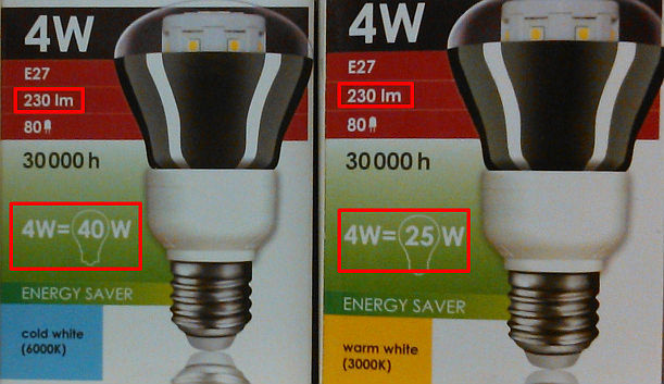

![[Obrazek: 73mdYRJ.jpg]](http://i.imgur.com/73mdYRJ.jpg)
![[Obrazek: VsmAlbT.jpg]](http://i.imgur.com/VsmAlbT.jpg)
![[Obrazek: NnesBs3.jpg]](http://i.imgur.com/NnesBs3.jpg)
![[Obrazek: L4C1LXJ.jpg]](http://i.imgur.com/L4C1LXJ.jpg)
